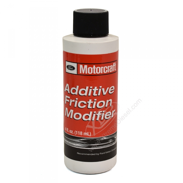

    Would be a great time to drain and refill the transmission. Don't forget the friction modifier.
    https://www.xtremediesel.com/mm5/gra...eb_600x600.jpg

    Thanks Sam. Yea, actually forgot to mention I already got a new clutch master cylinder. I expect that to be the problem for my pedal going to the floor like it does, and the clutch was about gone anyways before this. And I got the new fluid and friction modifier on the way with everything else.
