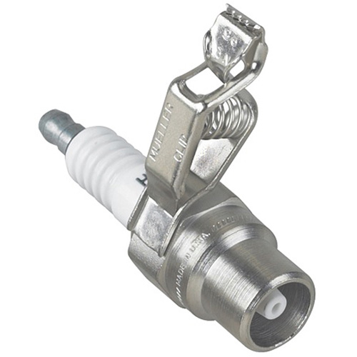

Final update on this: Got a spark tester from NAPA. Wire 6 is still kicking bright as the sun. Pulled the plug and it's soaked again. Seems that injector 6 is the culprit and is stuck open.
Here I go tearing it apart again! :D

Get a NOID tester and make sure the computer is not hanging the injector b4 u tear it apart.
I've had 2 '90's era 5.0 computers fail and leave voltage on the injector, causing it to stay open, nothing wrong with injector. I believe this is due to capacitor failures in the ecm, and may even b pretty easy to repair if someone is good/practiced at board level component R&R...

I'm looping back onto this trying to pull strings wherever I can. I'm still chasing this problem months later after finding a problem, fixing the problem, and finding out while it was A problem, it wasn't THE problem. I take it there is no easy way to get a noid tester down on the injector wires without tearing the supercharger pipes off, is there?
